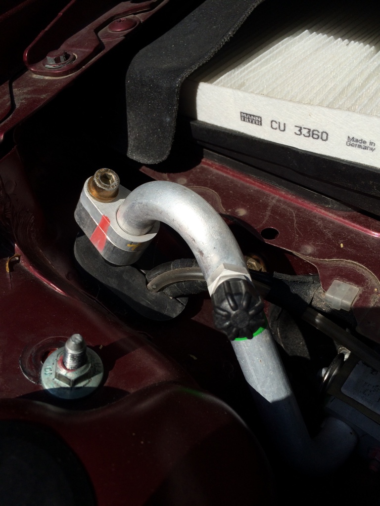

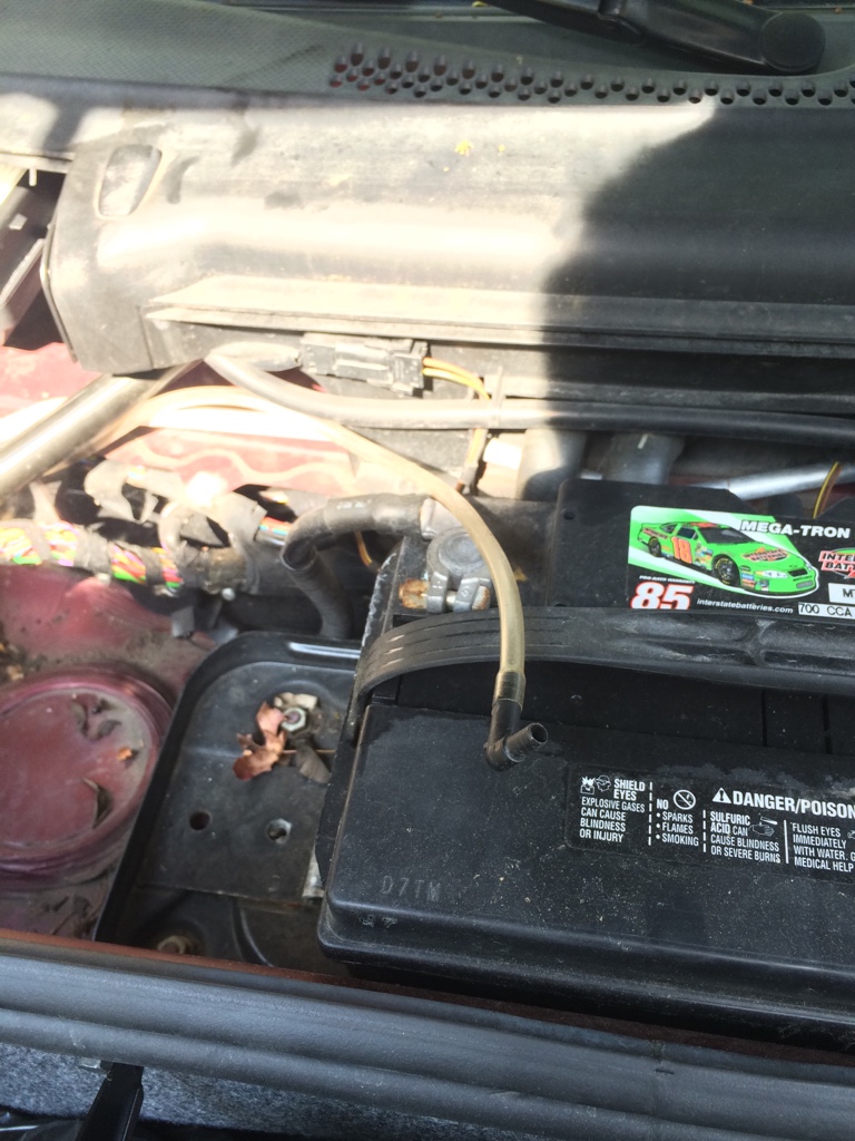

Noticed that this was unplugged today, but couldn't figure out where it connects. It passes through the passenger strut area next to a condenser pipe.
Battery vent maybe?
Attachment 19344Attachment 19345
san rensho 05-11-2015 11:44 AM
Yes, its the battery vent.
thstone 05-11-2015 12:24 PM
If the battery doesn't require a vent tube, then simply tie wrap it back out of the way.
NewArt 05-12-2015 04:00 AM
There should be a small hole on the end of the battery near the top.
Luv2Box 05-12-2015 06:27 AM
Some of the newer batteries have the vent hole in the middle back area where the decal of the car is. Your tube has the elbow in it indicating it was connected there at one time. If the opening is on the side it would not have the elbow.
