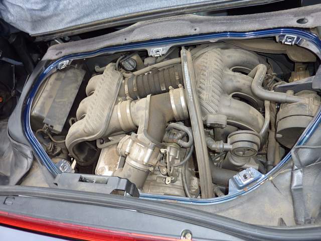

Timco 11-06-2014 05:16 AM
Is there a final word on engine washing?
All opened up for an alternator. Oddest thing. Just started slower and slower. No light show. New batt dead.
Going to clean the front, but what have folks gotten away with up top? I really want to pressure wash that baby!

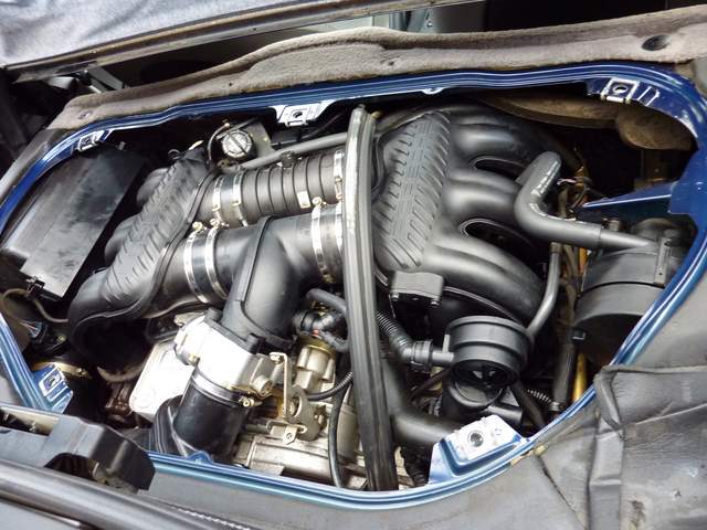

BruceH 11-06-2014 07:20 AM
Mild cleaner, gentle water and some elbow grease.
http://986forum.com/forums/uploads01...1415287166.jpg
http://986forum.com/forums/uploads01...1415287207.jpg

Lots of puddles. Seems to have all evaporated. Pics later. Citrus engine cleaner and garden hose. Looks great. Thanks!!
