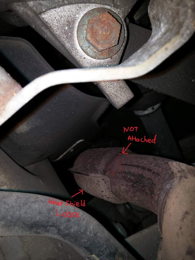

Einherjar 10-30-2014 05:50 PM
Found the culprit. Right side, heat shield near the Catalytic Converter...I think. The heat shield is no longer attached and just spins freely on the pipe.
http://986forum.com/forums/uploads01/HS121414720188.jpg
Pdwight 10-30-2014 06:42 PM
Very good.....I have to check mine
So....how would you repair that ??
silver-S 10-30-2014 09:12 PM
I would try a bead of JB Weld epoxy.
nieuwhzn 10-30-2014 09:28 PM
Have the same issue and have been whacking the heat shield for a couple years already.
Just drive the heat shield to the back of the car by hitting it with a mallet.
OR replace the secondary cats with test pipes.
Einherjar 10-31-2014 07:45 PM
gonna have a buddy of mine tac-weld it. Although I did not think of JB weld, may try that first.
