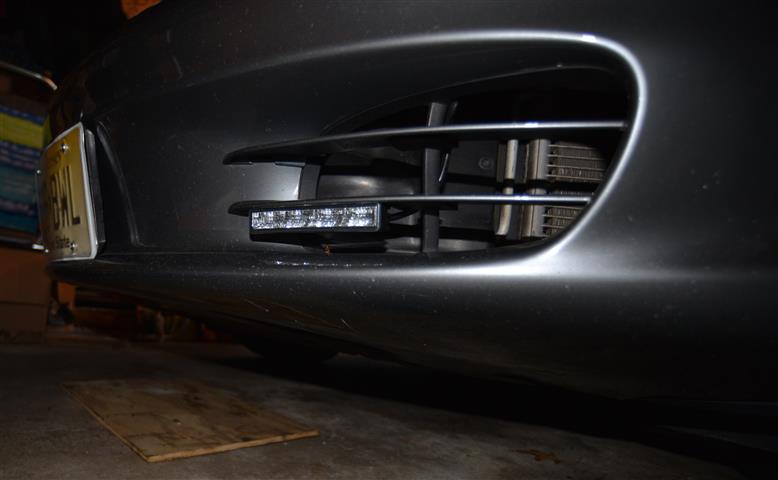

You need to find something that will fit the air intake. There are a number of posts on here and boxa.net on DRL installations.
This is what I fitted to mine - a single row of LEDs that were the brightest I could find.
http://986forum.com/forums/uploads01...1412054559.jpg

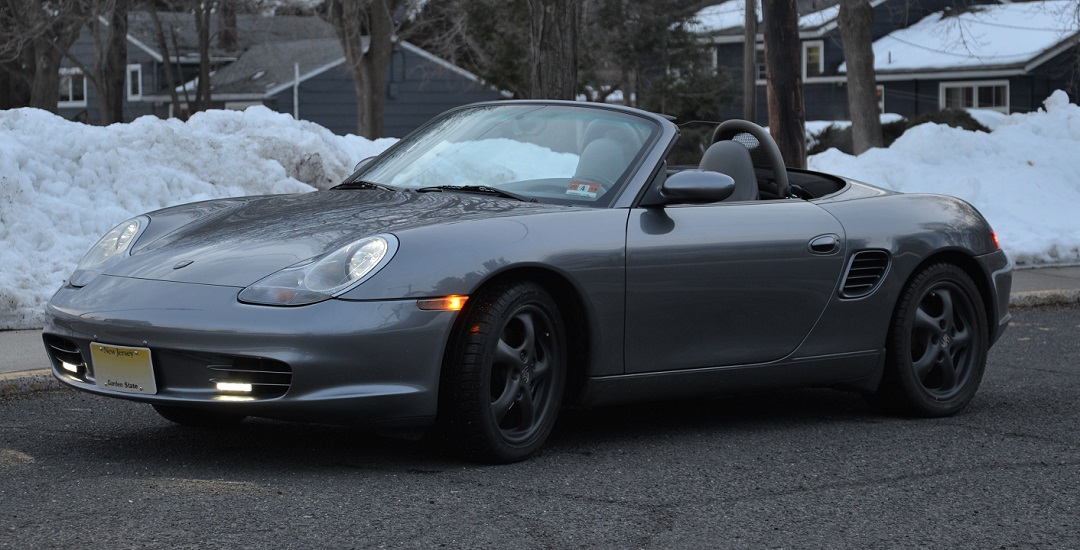

I have the Philips 4 LED strip...small, bright, fairly inconspicuous when not lit. I have the newer 986.2 bumper so not sure how they would look/fit on the 986.1
I installed the relay that turns them off when the headlights go on. I also added a dash switch to turn them completely off.
Attachment 18867
Attachment 18868
