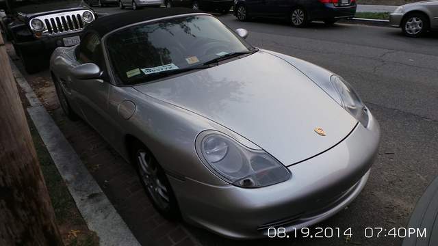

Max_V 08-19-2014 04:53 PM
Ok help me here...
First, less than a month old baby parked outside. It was clean until last weekend's storm... :(
