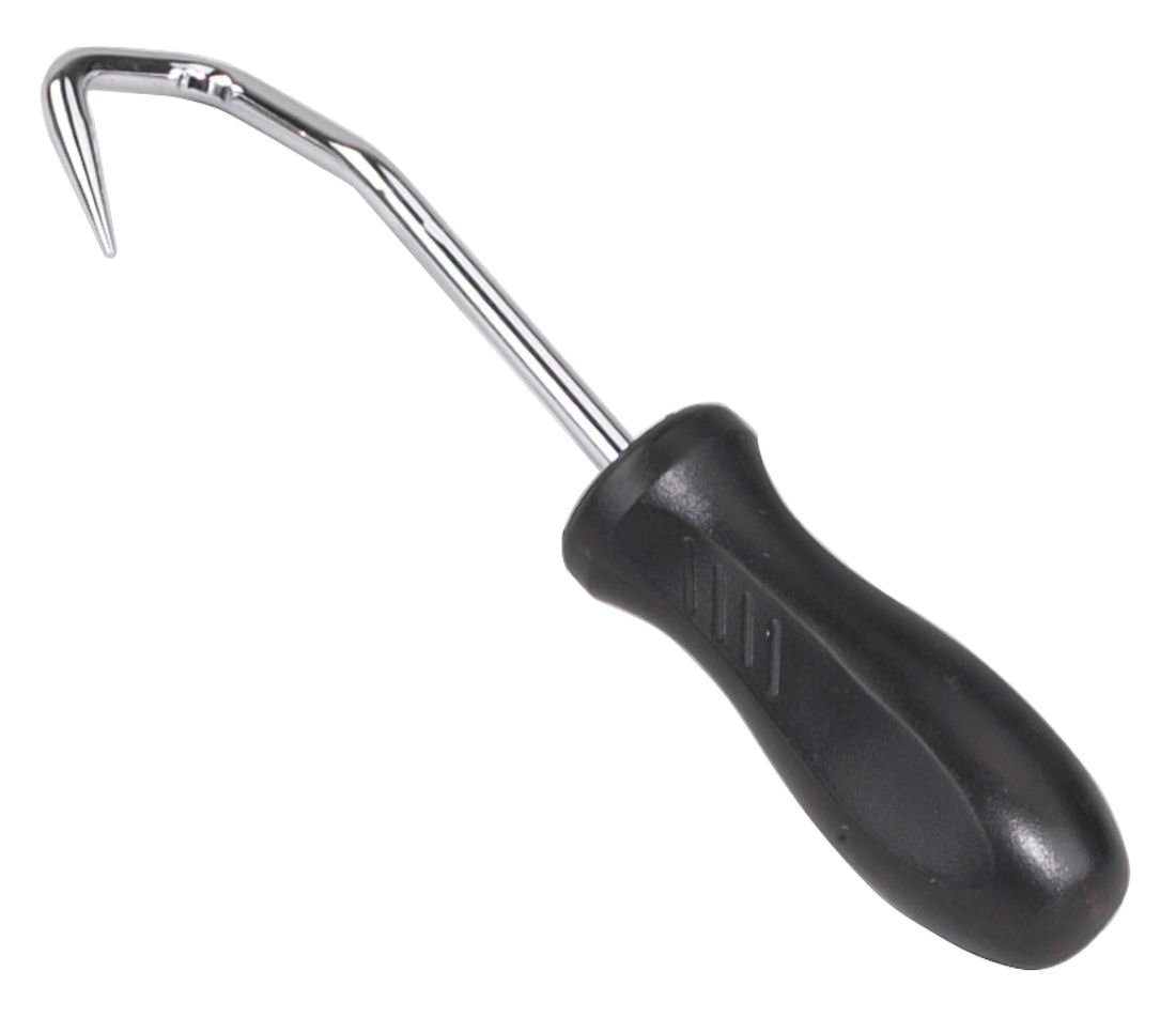

Originally Posted by Mark_T (Post 411060)
Flag down a Snap-on or Mac guy. Or Ebay
Or got to Amazon: Amazon.com: OTC 4521 Hose Removal Tool: Automotive
http://ecx.images-amazon.com/images/...L._SL1500_.jpg
Muzzle of Bees 07-23-2014 06:24 AM
Originally Posted by DennisAN (Post 411040)
Yet another Harbor Freight cheapie: $3. 8" Radiator Hose Pick
Yep, Harbor Freight had one. Its a further drive for me. It was about $3 and it worked great. I would have paid double that easily. I wonder why the "true" auto parts stores did not have one in stock? The guy at Auto Zone looked at me like I had three eyes when I asked about the tool. At Oreillys they were busy so I walked through the store searching for one. Nothing found.
JayG 07-23-2014 07:02 AM
+1 on harbor freight
Why if you can get a tool that you will maybe use twice for $3.00 pay probably 10 times that for snap-on or Mac ? Is the $3.00 one the same, probably not, but will do the job just as well.
