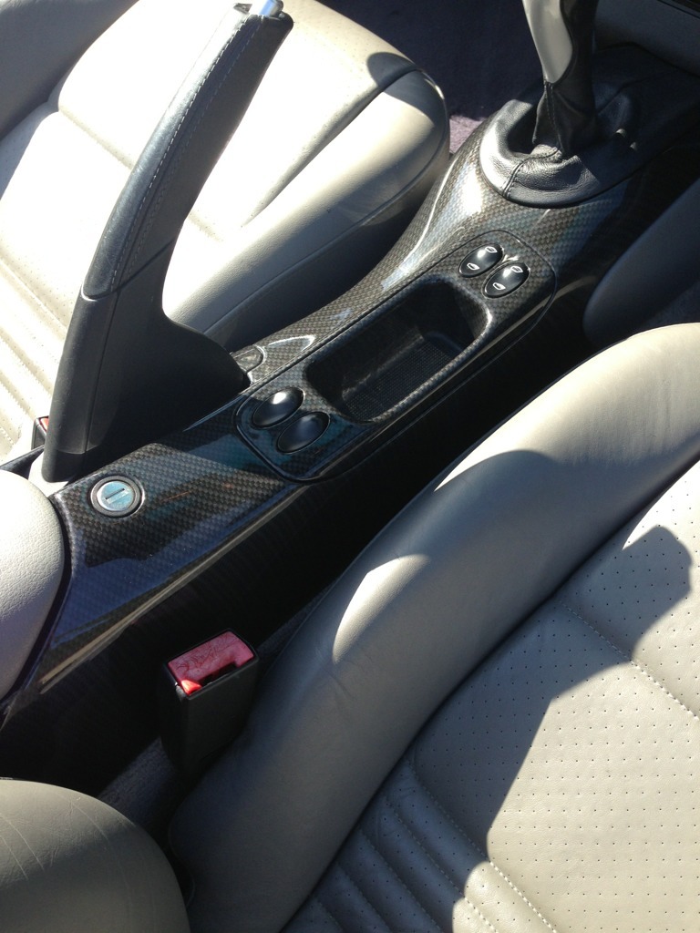

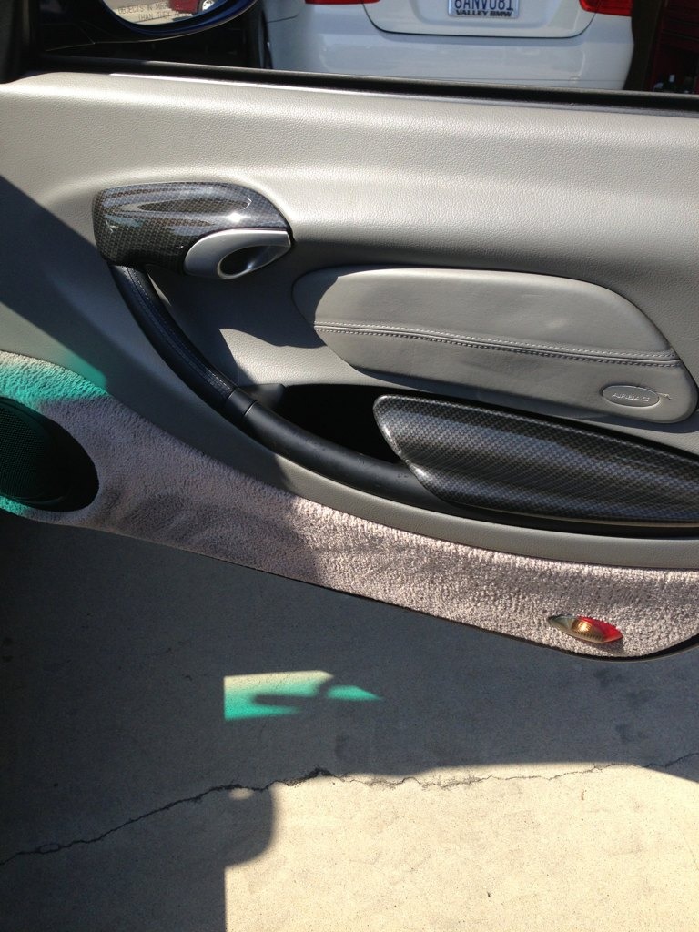

I got mine hydro dipped along with the armrests, door handles and door sills. Total cost $350Attachment 17762Attachment 17763
