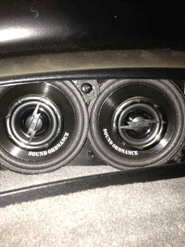

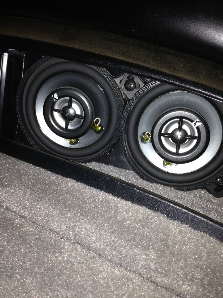

I jammed these 3.5" speakers from crutchfield into the oem mounts. Not the prettiest install but they sound great. I did blow the kicker's after 6 months but replaced with sound ordinance (both $30 a pair). I hope this helps.Attachment 17780Attachment 17781
