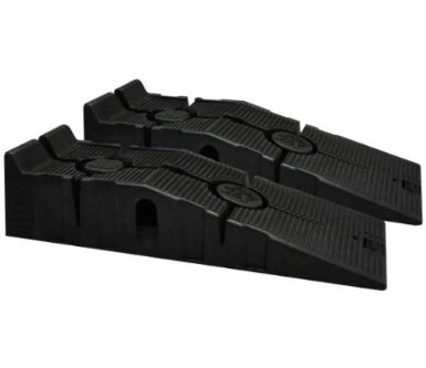

Taj 05-20-2013 10:18 PM
Ramps To lift Boxster
I've order 02 Sensor today from Autozone (Bosch brand). I'm excited to replace the oxygen sensor by myself.
Is there any idea to lift the car apart from using jacks. I've come across ramps. Seems like the ramps will work to lift up the rear tires. It lift's up 8."
RhinoGear is inexpensive, light and safe:
http://986forum.com/forums/uploads01...1369113362.jpg
