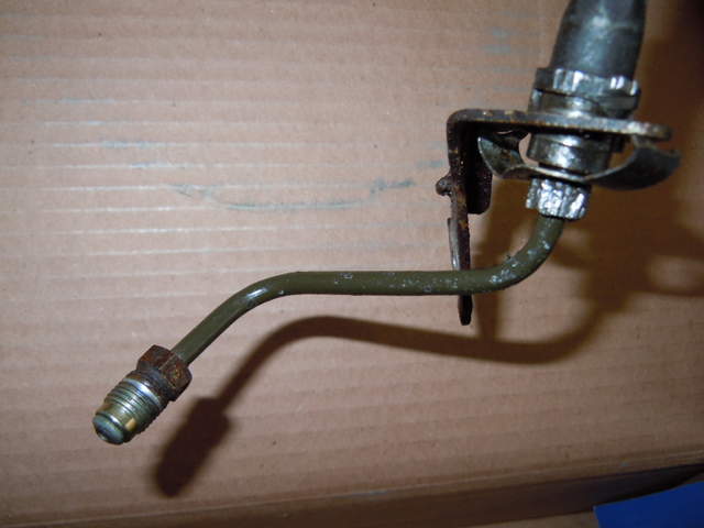

So this morning sun was shining and life was good again..Managed to shift the rear nut so 3 Shiny brake lines on now.. Hoorah!:)
The front O/S has given up the ghost, so took whole assembly off from back of the caliper and ordered a short hard line from Porsche (£11.00) so not too bad

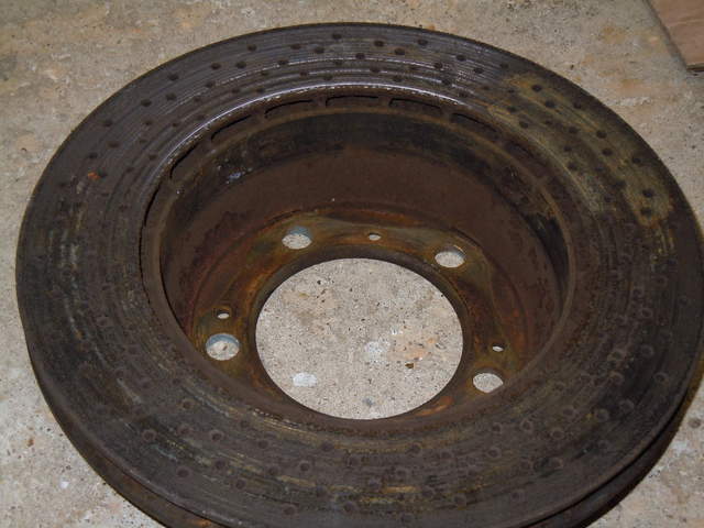

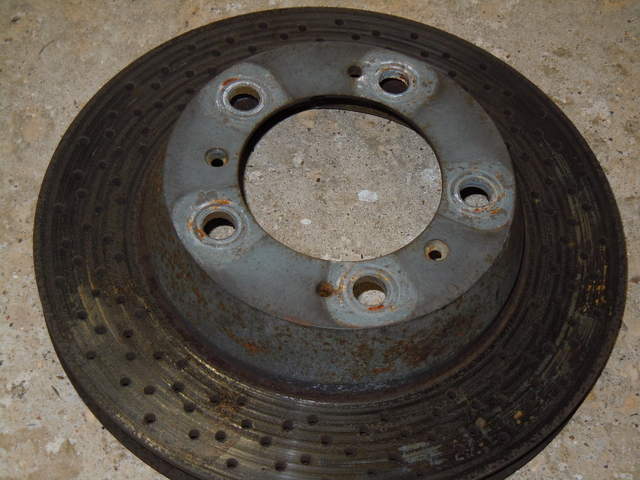

I went back to fit one of the new rotors on....the old one looked a mess once i had got it out and on the deck...shame as there was still plenty of life in the pads.
Have given the rotor top hats and edges a lick of Alum heat paint as these get rusty quickly....and i am a tart !! Looking good

So problem resolved...hopefully ..The back of the lines dont sit so tight in the holders so squezed the metal spring like clips together a bit which improved it..

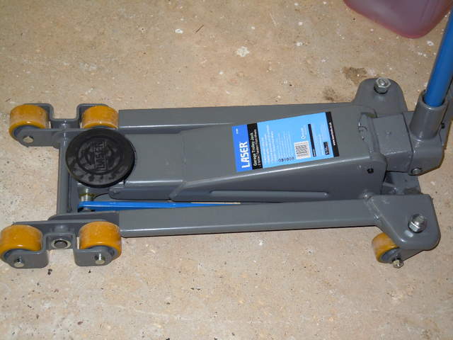

However the parcel man did turn up with my new trolley jack.....Bargain off of Amazon £150.!! retails at £350 over here !!!

Wow - that's some serious looking floor jack! What's the lift range?

Yeah pleased with the jack 500mm max lift..wanted a low profile to go under the Box with jack adaptor
