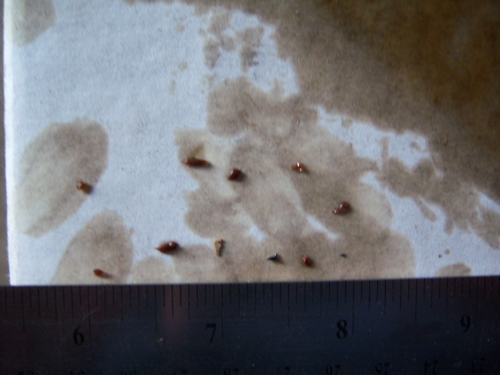

cut the oil filter apart -- found a few really small pieces of brown plastic ( about 1/16" in diameter)

here is a pic of the pieces of plastic i found in the filter and a sacrilegeous but easy way i found to work on my cars. whats 2500 lbs to a 15000 fork lift?
i will post if the tensioners remedy the clatering noise

Those brown plastic bits look like what I and many others also find in their filters. Probably chain tensioner plastic. It'll be interesting to see what sort of condition yours are in if you replace them.

The pieces of plastic maybe come from gasket, if they are soft, are gasket parts.
