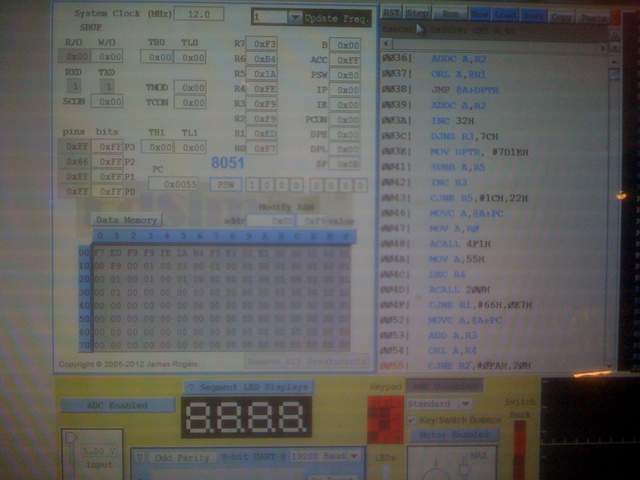

kashmir 09-26-2012 04:04 PM
Yes Ive have been messing with the ecu, this is what my boxsters coding looks like. it will take a lot of work.
http://986forum.com/forums/uploads01...1348700641.jpg

Kenny Boxster 09-27-2012 11:24 AM
Ah yes, I remember you discussing the subject a while back. Kashmir, I have tools and a durametric at hand, but I don't know if they will be of any use. I am really interested to see the software behind this.
